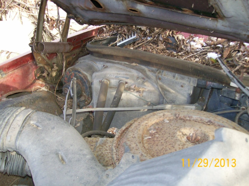

    Post  Sweet Seventy9 Fri Nov 29, 2013 4:15 pm
    Here ya go!  (the wiper arm is NOT included, lol)
    A/C Delete Box 100_1613
    There's a second car with a non-AC heater control in it but I couldn't easily get the hood open and it was too cold out to mess with it so I can't positively say the heater box cover thing is there.  99.999% chance it's still there though.
    I was only on a photo recon mission today, so I haven't got a price yet.
    As you know though, these things are a royal PITA to remove/replace because they're so heavily glued and screwed in place.
    Plus, everything is more brittle in the cold weather making it even more of a challenge to take out without breaking it.
    Because of this, it's not going to be cheap.
    If either of you two are still interested, lmk
    A/C Delete Box Empty Re: A/C Delete Box
    Post  solo79 Fri Nov 29, 2013 6:33 pm
    I feel like that Christmas commercial with the M&Ms. THEY DO EXIST!!! Wow, that box is completely different. Looks like even the heater core is farther over? That is perfect! I wonder if the firewall is the same behind it. That would be the only thing that would suck is if the firewall is designed differently, like the openings behind the box. I'm interested!! Wait til you get it out before you come up with a price.haha. It might go smooth and it might not. Be sure and take a picture of the firewall when you get it out too. I'm hoping to have my box out this weekend and then I can compare firewalls at some point. Great find. If there are really two of them at that yard, you should get the other one too if you can because I know bbody wants one as much as I do.

    Seriously, I think you have to remove the fender to get that box out. I just got done removing the dog house on my car and there are bolts down the left side and underneath that I'm pretty sure you can't get to unless you remove the passenger fender and wheel house. That will be a ton of work for you especially getting both of those boxes. However, if that is a 77-79 fender in that pic, I might be interested in the fender if it's in good useable shape (not rusted out or dented badly) dings are ok. You could raise the hood and prop it with a stick or something, then remove the one hinge to get the fender off which would save you from having to remove the whole hood. Still though a lot of work. I'll buy it from you if you get it out. You should get them both as rare as they are.
    Post  Sweet Seventy9 Sun Dec 01, 2013 12:15 pm
    Yeah, they're not easy to remove.  Most people I've known that removed theirs has used a BFH and smashed it apart, then fabbed a piece of sheet metal to cover the huge hole that's left.
    A/C Delete Box Tempor11
    I'll try to have a price for them tomorrow (monday) afternoon.
    I would have to have a commitment though, meaning payment, before any disassembly is started.
    NG on the fender, it's all crinkled up at the front.  it's a 78 btw.  I'll keep my eyes open for one for you.  Caprice or Impala?
    lmk
    ** EDIT **
    I just heard back from a friend about the removal .......
    "Passenger side inner fender and half the dash has to go.  have fun!"
    EEEK!!!!!  What did I get myself into?  LOL!
    ** 2nd EDIT**
    Bad news .... if you want the heat to work, it's not as easy as just switching over the covers.
    What my friend meant by "half the dash has to go" was this ↓↓
    "you have to remove the blend door actuator cable, vacuum lines, mode selector and etc.
    you also have to remove the ductwork from the box (7mm if I recall).
    I also believe anyone who switches to that box will require the heat only HVAC controls as well."
    That's his car in the pic, btw.
    If you want, I'll pull everything.  Just lmk.
