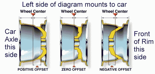

------- Offset Explained--------

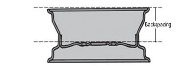

BACK SPACING is the distance measured from the back of the hub to the back of the wheel lip.
--------How to measure-----------
