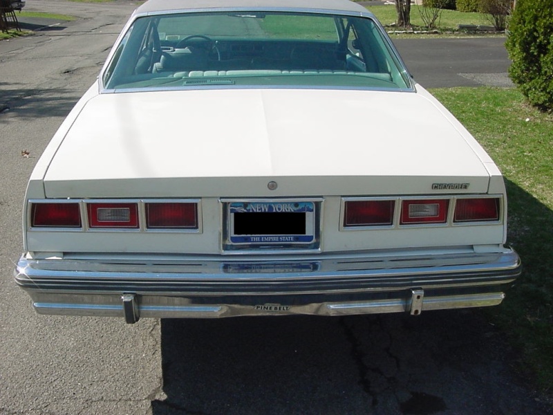

    I did!!! If you go look at my blue caprice in my thread, you'll see it has rear center bumper filler. Of course, I couldn't find it back then and I happen to be in Lowe's one day and was staring at this vinyl base board trim which is very thick and flexible. I can't remember the exact thing, but I was planning on doing the same thing again. It was easy to trim, install and paint and looked perfect I thought. I'm planning on visiting Lowe's or Home Depot to see if they still have this. It was maybe 3 inches wide and it was white. It had a little beveled angle down one side which made it rise just right on the bumper. I already knew I'd be doing this again. The car I just bought doesn't even have the filler on the bumper.
    BUMPER FILLER!!!!!!!!!! Empty Re: BUMPER FILLER!!!!!!!!!!
    Post  solo79 Tue Oct 29, 2013 8:43 pm
    I went and found a better picture of it on one of my many flash drives. I can't seem to find a real good picture of it as I apparently didn't take any close-ups of the rear bumper. At any rate, it's simply base board trim and it's just the right thickness:
    BUMPER FILLER!!!!!!!!!! Aqxu
    If you're interested, when I get to this point, I'll do a how-to on it.

    I bought one of those Replica Plastic ones. What a POS.......
    Post  GM B-Body Forum Sat Feb 01, 2014 10:06 am
    sorry im late, i didnt even know you responded. So they really are a pos?
    Post  Sweet Seventy9 Sat Feb 01, 2014 12:34 pm
    Yeah, it was nothing more than a cheap "Z" shaped piece of fiberglass.
    I had to measure and drill my own holes to mount it, and no matter how you mod it, it does not fill the gap properly.
    Instead of coming up at a slight angle like the factory one, like I said, it's "Z" shaped and is set back about an inch and a half or so from the rear fascia.
    People would be better off buying a couple tubes of silicon sealer and rebuilding the one they have.

    Thanks for showing pictures of that aftermarket one. I was thinking about that until I saw your photos and now I know I don't want it. I think I'll do what I did last time, but instead of using 3M double-sided tape which wasn't the greatest idea, I'll use something a little stronger like panel bond adhesive maybe. OR...maybe I'll just suck the bumpers in like that one car in the other thread. I can't get over how good that looks.
    Post  Sweet Seventy9 Wed Feb 19, 2014 9:58 pm
    solo79 wrote:Thanks for showing pictures of that aftermarket one.  I was thinking about that until I saw your photos and now I know I don't want it.  I think I'll do what I did last time, but instead of using 3M double-sided tape which wasn't the greatest idea, I'll use something a little stronger like panel bond adhesive maybe.  OR...maybe I'll just suck the bumpers in like that one car in the other thread.  I can't get over how good that looks.
    You're very welcome.  I'm glad they were a help.
