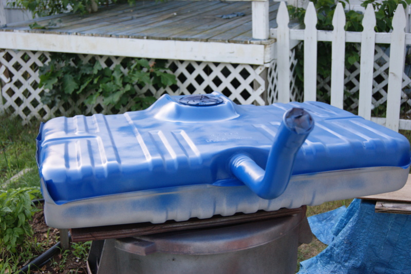

    I thought I'd share a few tidbits I found out about tanks rather than impress you with my two tone Paint job.
    I bought this tank off of Sweet79 thinking it's a 22gal like my original. Actually it's 24gal from a sedan 82 and up ?
    Before that most 24gal were Wagons at least this what I read. What I found out is there are 3 tanks 1 22gal and 2 24gal
    one for 2/4dr and the other wagon. The sender/pickups also have the 2 and 3 line version but there are versions for
    22gal and 24gal. I guess AC was the factor for the return line rather than just vapor line on some but not all as mine
    had AC and no return line. If anybody has something to add or correct please just thought I'd toss it out so you might
    not make my initial assumption that there wasn't that much variation on these.
    (also I'm not done painting the tank lol)
