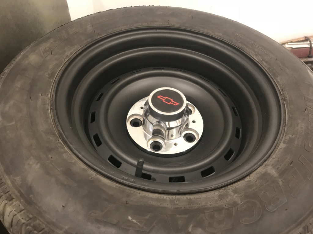

    cleaned and painted these wheels to fit on the rear end. had to change the front spindles since bolt pattern is different.
    The Never Ending Project (86 caprice lq4 4l80e) - Page 2 210

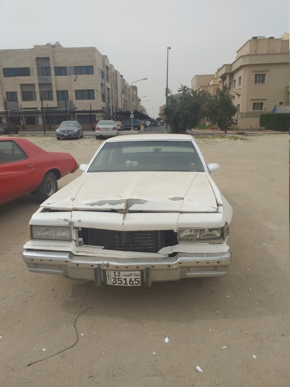

    Crashed the car because why not.
    The Never Ending Project (86 caprice lq4 4l80e) - Page 2 610
    Changed the driver side fender, hood, header panel and core support.
