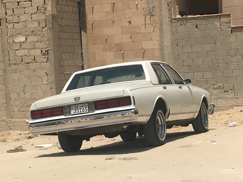

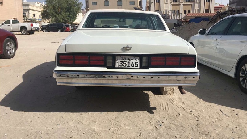

    Here is the car when I first bought it.
    The Never Ending Project (86 caprice lq4 4l80e) Img_1010
    The Never Ending Project (86 caprice lq4 4l80e) Img_1910

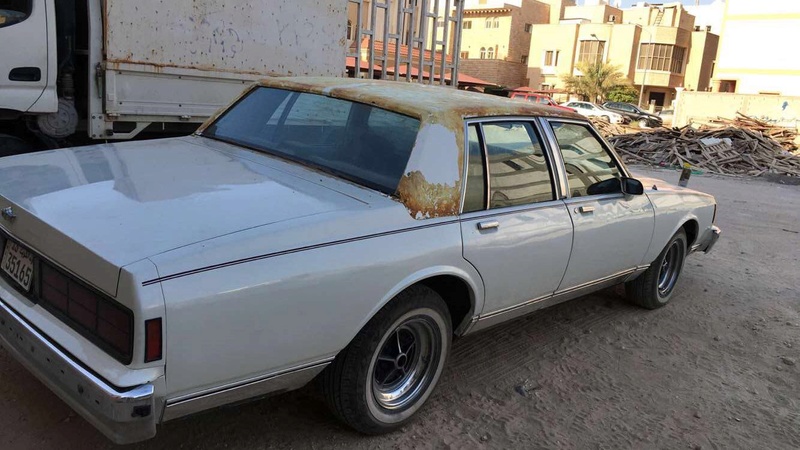

    Removing the vinyl top.
    The Never Ending Project (86 caprice lq4 4l80e) Img_2510
    The Never Ending Project (86 caprice lq4 4l80e) Img_2610
    Used brake clean and WD-40 and scratched the glue with a penny xD. took me two day maybe a total of 13 hours.

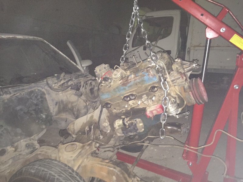

    Engine and trans out.
    The Never Ending Project (86 caprice lq4 4l80e) Img_3010
    The Never Ending Project (86 caprice lq4 4l80e) Img_3011

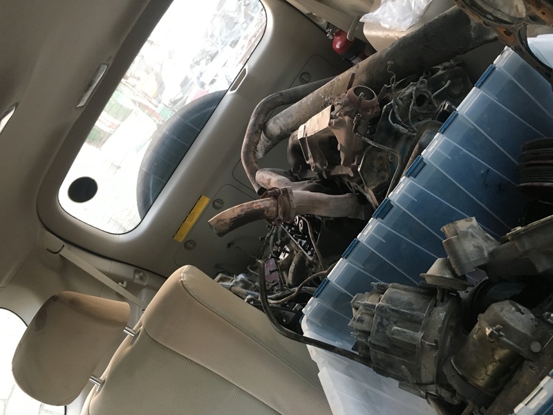

    Going to the junkyard to sell everything I took out from the car that was not going to be used. before I took the engine to the junkyard I took off the heads just to see If I was right about the head gasket. And I think they put the wrong gasket because it was blocking some passages for the water I wish I took a pic to show it here.
    The Never Ending Project (86 caprice lq4 4l80e) Img_3012
