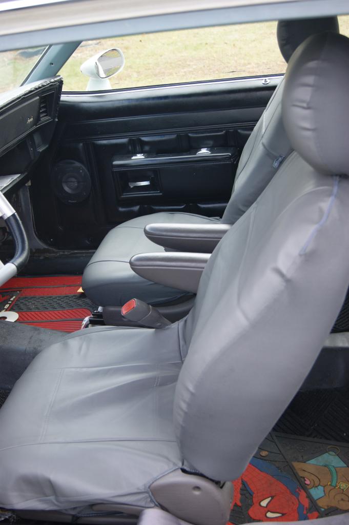

    I installed PT Cruiser seats (02' I believe) relatively easy to cob in I used a piece of square steel from a sign as the
    mounts for the back part and put the front on the factory pan mount. They might be a tad high in the back but I
    have sat in them for two years without issues. I should add I did not use the PT base for the seats as they would have hit
    the roof if I did. But that was an add on to the seat to raise it up for the high roof PT.

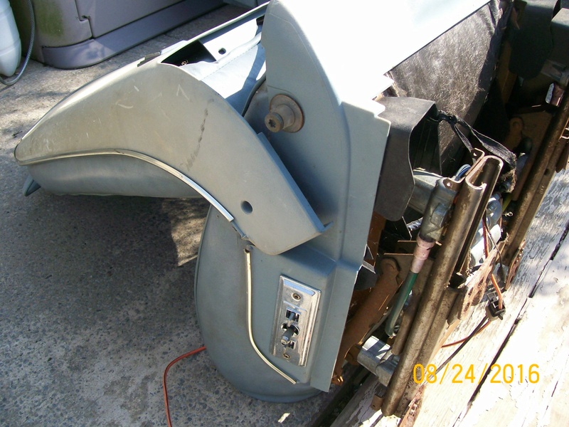

    These are out of an Olds Delta 88 Holiday Edition. They're direct bolt-ins. Since they're from a B body, they're the correct height too. Although they look similar to G body seats, they're bigger. The driver side is 6 way power.
    Seat upgrades 100_2910
    They're for sale btw. $200.

    Sweet Seventy9 wrote:These are out of an Olds Delta 88 Holiday Edition.  They're direct bolt-ins.  Since they're from a B body, they're the correct height too.  Although they look similar to G body seats, they're bigger.  The driver side is 6 way power.
    Those do in fact look just like Cutlass seats. Never noticed that. Interesting. I like those! I like the Audi seats in B-Body's car as well! I had Cutlass seats in my first Caprice several years ago and they fit good and were a good height, but I had to fashion brackets for the center since that car had a full bench originally.

    I have a Cutlass with similiar seats. They look the same. Curious on how much size difference the Delta seats are to the bucket Cutlass seats. I see the cutlass seats all the time.

    caprice85 wrote:I have a Cutlass with similiar seats. They look the same. Curious on how much size difference the Delta seats are to the bucket Cutlass seats. I see the cutlass seats all the time.
    The seats are approximately 3" wider and a couple inches taller than G body seats.
    The plastic "shell" is shaped differently also.
