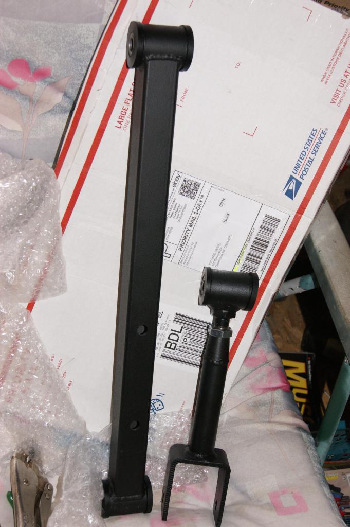

    Post  Myloth Thu Feb 16, 2017 1:37 am
    Yea the interchange with 70-81 F Body is nice things like 1.25 front sway bars are sweet for our cars. I have the 1.25 sway
    but I put in original upper/lower front along with SouthSide rear arms replacing the stock Upper (Junk) and 9c1 lowers (ok).
    these make your rear wicked tight feels like a Camaro around corners instead of a Full Size car(Nevermind that I have stock
    ride height which is about 7-8" clearance).
    Aftermarket front upper and lower control arms  Souths10
    In fact the sway and rearend make me want to swap the Front arms for tubular and the Body Mounts for Poly as I can feel
    weakness there. This place has almost everything but they are little pricey .
