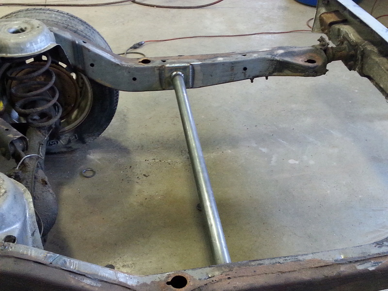

    My New Project 20170110
    My New Project 20170211
    My New Project 20170212
    I have not made any progress on the 1981 Impala because I went and bought 2 more B bodies. One is a 1981 Buick LeSabre and the other is a 1979 Chevrolet Impala. I got the 1981 Buick LeSabre first because it is really solid. It is getting a 6.0L/4L60E set up. It had a 2.41:1 axle ratio in it but because I am putting in a OD transmission I want to have a good gear ratio in it. The only problem is the Buick came with a 8.75" BOP rear axle witch has very limited ratio choices. So I took the 8.5" BOP rear axle out of the Impala and put it in the Buick. It is getting an Auburn posi and 3.42:1 gears. This created a hole new set of problems. I wanted to use the big brakes on the Buick but the bolt pattern is different. So I put Camaro front rotors on that were the same diameter and the 5 on 4.75 bolt pattern. The rear is getting S10 caliper brackets and disc brakes. It is too bad the Impala was parked on grass for 5 years. It rotted out the frame and floors and became a hotel for mice. The mice were every where in the car. I am really bummed about the condition of the Impala because it is such a better looking car.

    Nice work on the frame dude. one question though how did you learn to fabrication ?. I don't know anything about fabrication and welding but I really need to learn.
    Age : 76
    My New Project Empty New project
    Post  terry cronk Thu Mar 02, 2017 10:54 am
    In the later picture you have welded in a tubular support for rigidity.
    Is that just ahead or behind the fuel tank?
    Or are you going w/fuel cell in the trunk area?
    Is that an LS block? Looks like the adapter plates from a Gen. 1 engine position.
    So I guess using solid mounts are a "GO"!
    Beautiful frame/welding job by the way.

    Just from looking at it i can tell you its almost in the middle of the fuel tank, he must be going with a fuel cell.

    Post  BrokenBlazerDave Sun Mar 12, 2017 8:42 pm
    Sorry for taking so long to reply. I really wanted to add some pics but had not been making very much headway. I have a few pics now. To answer a few questions first.
    I am going with a fuel cell. The red 1981 is just for drag racing. I welded in that rear bar for rigidity but still may chop the back of the frame off to fit really big tires. That is still up in the air though. It is an LS block with Holley G-body swap mounts to Energy Suspension motor mounts. I have no sentimental attachment to the red car so I am going to chop the crap out of it. I added the weight of the frame bracing because my other car is cracking the roof from the twist it has. I will have to cut a bunch of the floor out to clear the crossmember.
    I will get back to the red car soon.
    I want to get the Buick done first to see if it works good.

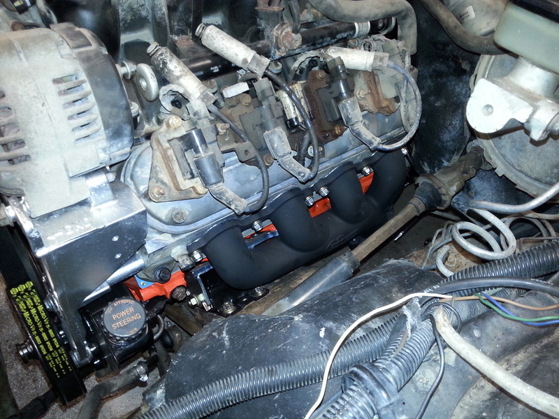

    Post  BrokenBlazerDave Sun Apr 02, 2017 12:57 pm
    Had to remove the fan shroud and fan to have enough room to get an air intake into place. This is a Crown Victoria fan I think. It is what the local auto wrecker had sitting on top of the pile of electric fans. I put some exhaust on yesterday also.
    My New Project Dscf1111
    My New Project Dscf1110
    I got the gauges installed but still have some work to do on the interior.
