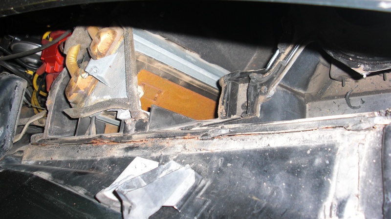

    So do you find water puddling up on the passenger side floor board? And cant find the leak? 99.99999999% of the time, if not 100% of time its the heater box. All b bodies from 77-90 are notorious for leaking. Its a common rust area, and over time the sealer in the heater box dries out and cant hold water so it comes in. The seal around the firewall can normally be reused, but youll have to fix the rust damage, but i recommend replacing the firewall seal with the general automotive weather strip, that you can find at your local auto parts store. Its quite a fun project, you need to remove the fender to take it off, you may be able to get away with removing the wheel well, but the whole fender is easier, and its actually not very heavy like I thought it would be. If you do find yourself doing this, use a silicon sealer and glue all the seams in the heater box, because if you only fix the seal around the firewall, your still leaving a chance that the heaterbox itself will leak, if its not already. Once you take it apart youll see how its designed, youll need to take it all apart to remove the old glue, just silicon it all up, and it should be all she wrote!
    Leaking Heater Box Disassembly Cimg6610
    Leaking Heater Box Disassembly Cimg6611
    Leaking Heater Box Disassembly Cimg6612
    Leaking Heater Box Disassembly Cimg6613

    Looks like an adventure. The heater box on my Cutlass was leaking a few weeks ago. I didn't have to go as far as you did to fix mine though.
    I definitely wouldn't ditch it completely. It's worth it to keep the heat for the fall or winter evenings.

    Yeah, im gonna keep it, i might even put the ac back in one day. It wasnt leaking.... yet haha, but i had a problem with my other caprice that did, and it would fill the passenger side up with water when it rained, so i just wanted to be safe, but its garage kept anyhow. And yeah, i gotta get me a set of those window sweeps too, dont know how long they'll be around!!

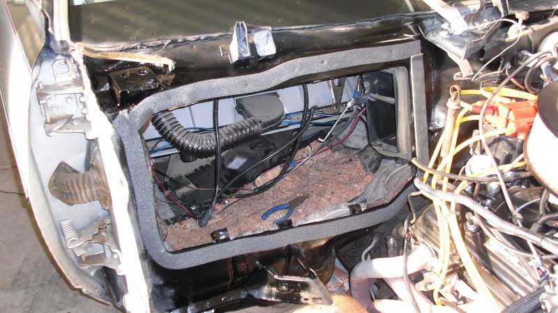

    Well, I started on this project this evening.  It wasn't ideal but I decided to do it out in the driveway since I would have to move other projects to get it in the garage.  It wasn't bad while the sun was still out but once it started going down the temp dropped to around 40 and was going down from there.
    It took me quite a while but I do have the heater box assembly out of the car and ready to pull apart and reseal it.  I opted to remove the inner fender completely but not to remove the entire outer fender with it, mostly because I didn't have anybody handy to help take the hood off, and I've never been a fan of working with a hood propped in place with one hinge removed.  It would definitely be possible to remove the heater box by just loosening up the back of the inner fender as was mentioned earlier in this thread but I decided to just get it out of the way.  That also gave me a chance to clean up the battery tray and around that area.
    The heater box itself wasn't that hard to remove.  I fought a bit with getting the top off just because a couple of the bolts were hidden under some built up debris down in the well area below the windshield.  Once I located those the top came right off.  I had no problem with pulling the evaporator out with the hoses still attached, also as someone mentioned earlier.  There was plenty of play to swing that entire assembly up towards the front of the car and out of the way.   I left the heater core in the box until it was removed and just pulled the hoses off.  I lost very little coolant taking it out.
    The biggest problem I had was figuring out where to disconnect the wires and vacuum lines that run through the heater box.  I ended up disconnecting everything from under the dash  and then all the wires just came out with the heater box.  Looking back it was quite a project and there may have been an easier way.  Too late now.  I'm still hoping to get some time on it tomorrow but I have some other things going as well and I also still need to pick up some weatherstrip and silicon first.  There is a little bit of rust to fix but nothing serious.  Looks like part of my problem was the drain was just about completely plugged.  The sealant was also pretty bad in at least one spot so it probably would have leaked anyway, but the plugged drain likely made it worse.
    I was pretty tired of working on it by the time I called it quits for the night.  There is no turning back now though--just have to find the time to get it back together.

    Its good your catching the problem now, dont need to see any more rust damage and mold to these increasingly rare cars.
