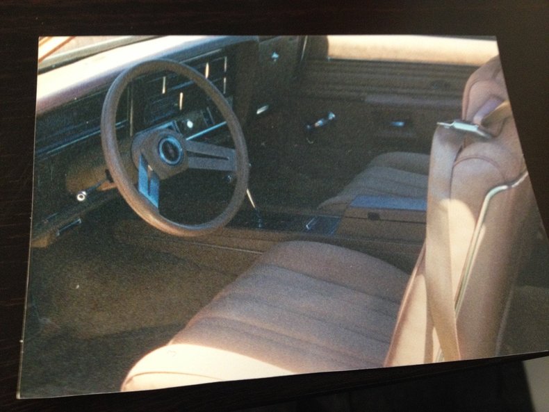

    any body done a floor shift conversion in a 77 ? if so what steering column did you use? i'm thinking a monty carlo of the same vintage will work. i'm in the final stages of parts collecting for my 77 caprice project, bought the car in 91 from a little used car lot and set it up for cross country travell. parked it in 97 and last year decided it was time! so far I have a 9c1 chassis from a 95 cop car, a 454/4l80 from a 95 chevy 2500 2wd and seats and floor console from a 79 grand prix that was installed on the first build. will post some pic's of the build as it gets going,any info will be apriciated!!

    Hi! Welcome to the Forum! I too will be embarking on a floor shift conversion for my 79 2-door. While I haven't done it yet, I've been studying steering columns. A friend of mine has a 77 Trans Am and his column is very similar to mine except without the column shift and I think I can make a 2nd gen Trans Am column work, but not real sure yet. I've also thought about removing the handle on my column, grinding down the mount and fill it smooth since there's absolutely nothing wrong with my tilt column and it's still nice and tight. I'm thinking about using a a square body 82-84 Trans Am console and the floor shifter as well. The boxy lines should go well with the car and after roughly test fitting the one from my Trans Am, it will just about mate up with the bottom of the Caprice dash in a nice transition, but will still require a little bit of work.
    Sounds like you've got some cool mods going already and I'd love to see pics of the Grand Prix seats and console in there. I bet that looks sharp!

    thanks for the welcome! I am trying to bring to life a vision in my head that started about 30 years ago, I guess that I am going for a grand touring resto mod using as many factory parts as I can.
