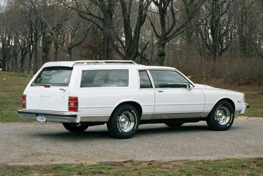

    Wagons are COOL!   I've always wanted a 2dr version.
    bolt pattern X0m095ifwqyoccx4g

    It's a Custom I found on the internet.  I Photoshopped a 78 wagon into a 2 door a few years ago but cant find it.  It looked fantastic.

    This picture messes with my eyes. When I see two doors, I keep picturing the trunk and back glass is there. That is really cool. I've never seen a 2-door wagon. I like that.
