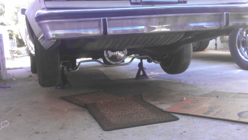

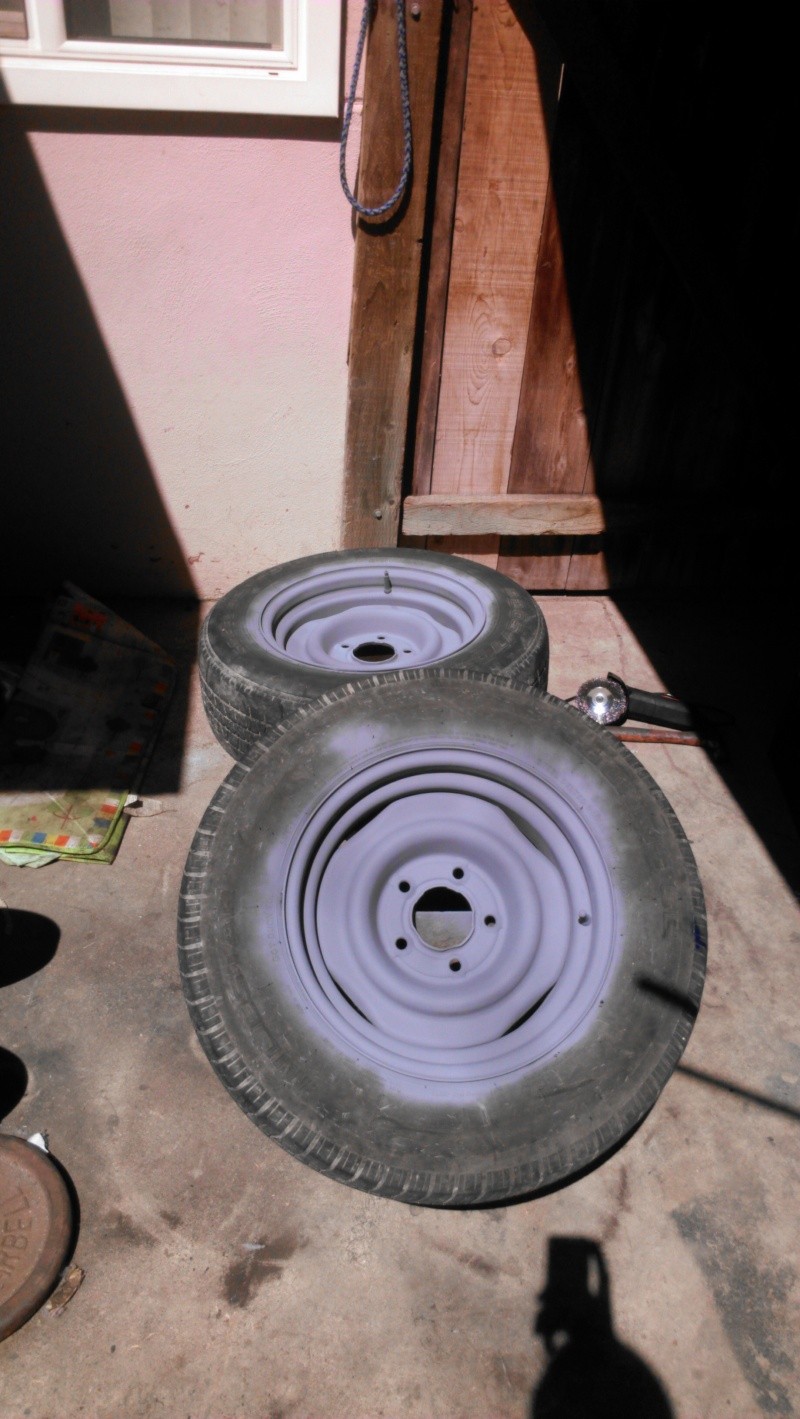

    for those following along with my other post and answering questions I thank you for giving info. Thanks to admin for his other post on the same swap his was a blueprint for me.
    The rear end was removed from a 95 impala ss  ,it came to me in a weathered and beat up unit but the posi worked perfect so I overhauled the brakes changed the fluids, seals ,c clips and lock bolt
    I painted up the rear and brake parts and put the chrome cover
    When swapping from drum to disk change the combo valve for disk/disk application, my brakes still  preform excellent with the smaller master cylinder, step on the brake hard and my face is in my lap!lol
    The 90 caprice master I was gonna use didn't fit the booster so I will need a 90 caprice booster to "finish" it off.
    Anyways here some picS
     From when I got it, installing , and completed...enjoy!
    95 impala ss rearend swap into 77 caprice Image19
    95 impala ss rearend swap into 77 caprice Image20
    95 impala ss rearend swap into 77 caprice Image22
    95 impala ss rearend swap into 77 caprice Image24
    95 impala ss rearend swap into 77 caprice Image25
    95 impala ss rearend swap into 77 caprice Image26
    95 impala ss rearend swap into 77 caprice Image27
    95 impala ss rearend swap into 77 caprice Image28
    95 impala ss rearend swap into 77 caprice Image29

    Post  HeavyChevy77 Sun Mar 29, 2015 9:12 pm
    Thanks mayne it took me longer than expected to do the job
    i started around 130 then stopped at 5 cause my sis needed me to move a table to her pad
    by then the axle was put then the next day i had to slide the axle beacuse it was too talk to roll under the car like i thought i could
    i had one end on the carpet on the ground and the other end on the jack and had my hand under when i pulled the axle foward it slipped and the shock mount on the axle landed and pinned my hand down..Hurt like hell and thought i broke it but i can move my fingers so it works lol it got in the tissue/muscle area between the thumb and finger on the palm side.
    i should have picked it up by the center but my weak ass jack has a small mounting surface bout the same size as a soda can top
    i took a five minute breather and carried on with the install
    i removed the arms and swaped in the new ones slid the axle in and changed the combo valve
    by then i was too beat to bleed the brakes and just waited till today
    HUGE DIFFERENCE
    accelerates way better even more when u get on it and smokes both tires up whenever u ask for it  Tho it feels like it would rather hook and pull than sit and smoke the tires
    And the brakes are awesome ! no lag in the braking like with drums but they did preform pretty good
    if you havent changed the combo valve yet you should the brakes will work way better it $50 bucks on ebay i got mine from HOTRODBKR
    I got the old combo valve for sale still in excellent condition for disk/drum if anyone interested  has chrome finish
    fourm member 25$ +shipping
