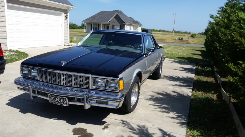

    Before: (i had to find some old pics, i forgot to take pics before i did it)
    Bumper tuck  Screen10
    Bumper tuck  20140610
    This is what it looked like when i first bought it:

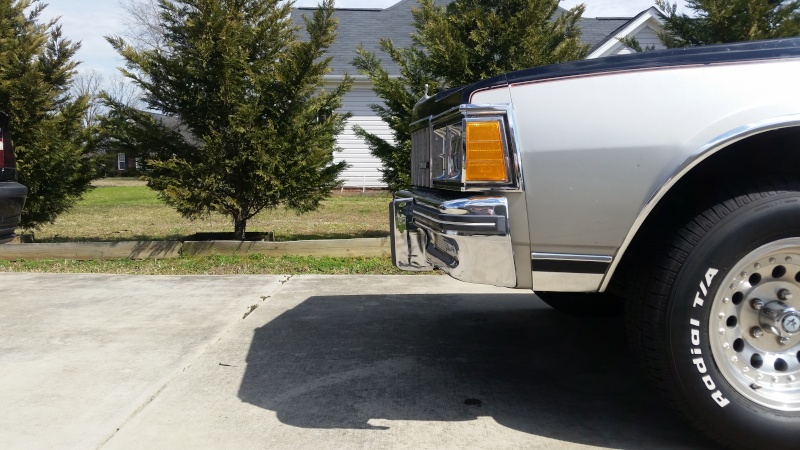

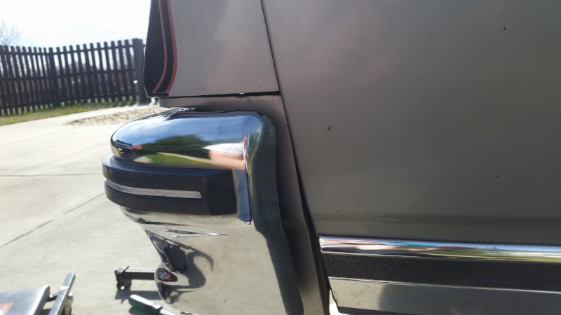

    And now the after:
    The front is sitting up high because there is over 100lbs off the front, no cyl heads, intake, battery, etc
    Bumper tuck  20150310
    Bumper tuck  20150311
    Bumper tuck  20150312
    Bumper tuck  20150313
    Bumper tuck  20150314
    Bumper tuck  20150318
    Bumper tuck  20150316
    Bumper tuck  20150317
    On the bumper filler i had to cut a small notch out in the rear so the rear bumper would fit into it, the front bumper filler, you dont even have to touch.

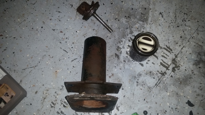

    Now on to the shocks, i took the rear bumper off first and i tried to drill a hole in the back of the shock, that was taking to long so i decided to grind a small slit which was much faster, but in the back of the shock ( ive discovered this is a twin chamber shock the rear part holds all the oil and the front is just loaded with gas) anyway when i cut the back of the shock oil sprayed out for few seconds, but i still couldnt get the shock to retract, it would bounce back to full length, so then i decided to cut the back completely off, and then it finally stayed, but thats when those parts i mentioned earlier flew off and hit me in the chest. Anyway im saying this because on the front, i did it the opposite, i cut a small slit in the front chamber and all the gas came out instead, a little bit of oil came out but not much, i was then able to push it in and it stayed, so all you have to do to make it easy is cut, drill a small hole on the front chamber, the actual part that sticks out from the frame, you dont even have to remove them or the bumpers like i did.
    Bumper tuck  20150319
    Bumper tuck  20150320
    That part with the rod is what shot off when i cut that end off, SO DONT DO IT THESE THINGS ARE STILL UNDER HIGH PRESSURE!!!!!

    Oh yea, that looks good!! I like it and the more I see it, the more I'm thinking of doing away with the bumper guards too for that smooth appearance. Probably the only thing I would want to remedy is the space between the rear bumper and quarter and the space between the front bumper and fender not being the same. That would bug me on my car. I'm wondering if it's possible to line the back of the front bumper corners up with the turn signal bezel? I'm thinking if I go that far in, I'd have to do away with the bumper shock and fashion a metal plate to bolt right to the frame to accept the bumper. Wonder if there's enough room? Gives me ideas. The back bumper looks like it could just about meet the line of the parking light filler. How much gap does it leave under the tail light panel between the bumper, is it about the same as the front?

    Hey guys, ill get a pic uploaded as soon as I can, and the cylinders stay decompressed I assume because of the rust and dirt build up and its a pretty tight fit anyway, but I've had it this way going on 3 years now and they haven't moved at all.

    Here's the pic looking directly at the rear
