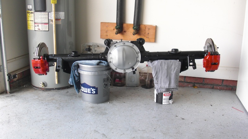

    Post  HeavyChevy77 Thu Mar 26, 2015 6:43 pm
    Thanx gooched78 ..if I didnt live in Cali I'd already have header straight pipe with a nice slightly lopey idle cam  and some nitrous etc,etc,etc... *sigh*i can only dream ..,or shell out the dough for the carb legal parts(headers$400 vs $150 I can make my self with smog tube for emissions but no sticker no pass)
    I'm getting thing prepped for install and cleaned and painted the rims I got at the junkyard and touched up the calipers and painted the parts of the rotor that doesn't touch the pads... I dont even want the tire guy to mount the wheel cause he might scratch the caliper its a close fit on the caliper to rim clearance I can barley stick a finger between em, plus I get pissed when those monkeys tighten the shit outta em with the impact gun. But anyways here's a fresh pic I had I knock the dust of the axle.Tomorrow I install can't wait!bounce
    How to ID your rear end- GM 10, 12 bolts 7.5, 8.5, 8.75, 8.875 Image18
