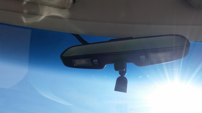

    I put the antennae receiver/ status indicator on top of the rear view mirror, this is a dual vanity mirror i bought used on ebay a few months ago, I believe its from a late 80's early 90's camaro or corvette or something lol
