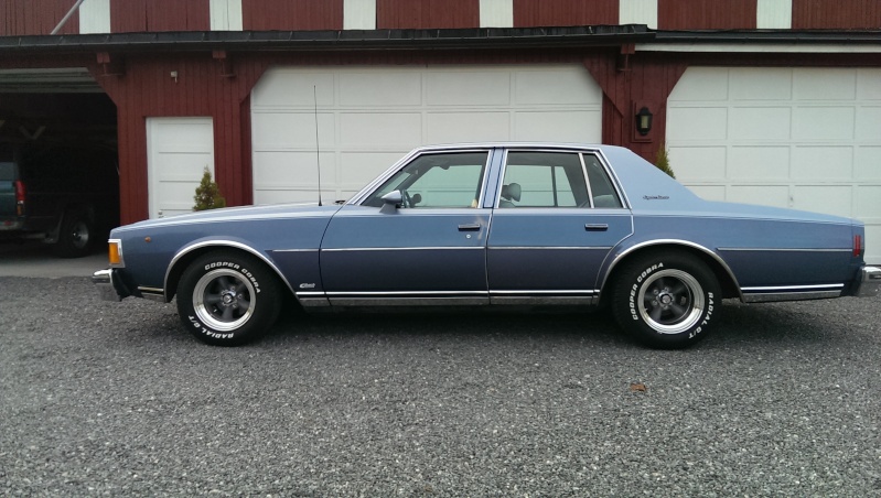

    Here is a picture of the car right after I got it home
    Installation of Eibach Pro-Kit Lowering Springs on a 77 Caprice Bilde_10

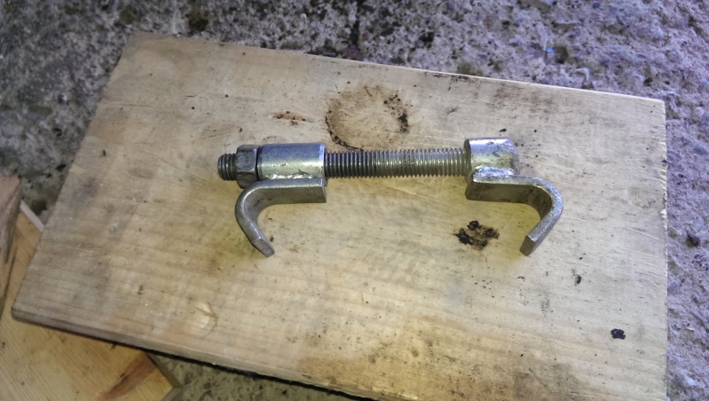

    Next step is to remove the springs.
    I used two spring compressors of this kind. Remember to lube the threads!
    Installation of Eibach Pro-Kit Lowering Springs on a 77 Caprice 2014-014
    I like to jack the control arm up to compress the spring as much as possible before I put on the compressors.
    It wasn't a lot of space there, so I put the compressors inside the springs instead of outside.
    Then I could use a deep socket to tighten them through the shock hole in the control arm.
    Installation of Eibach Pro-Kit Lowering Springs on a 77 Caprice 2014-015

    `77Box wrote:Oh yea I like those wheels man. I bought that same lowering kit for mine, tried too install it and the spring compressor I borrowed failed on the first spring and almost took my buddy out at the knees so I was only able to do the shocks. But i bought my own compressors and just haven't had time or proper weather too install them yet. Iv been torn between getting the torque thrust wheels or the black ones in your first pic but I think I like those black wheels a little more where did you get those ones at??
    It's tight around the front springs, but with a little work and two jacks you'll finally get there Smile
    Safety first. So if you think it won't hold, it probably won't..
    I really liked the look with the black wheels as well.
    Only thing is that I'd like the front wheels to stick more out in line with the fender.
    They would probably stick out more with 245's instead of 215's though..
    I got them "used" from a guy who had realised that the 10" with 4"BS didn't fit his Firebird.
    Brand new wheels at a bargain. Earned $150 when I sold them Smile
    They're Cragar Soft 8, and the dimensions are mentioned above.
    Summit sells them.
    Here's a link to them on Summit.
    http://www.summitracing.com/int/search/product-line/cragar-soft-8-black-wheels?SortBy=Default&SortOrder=Ascending&tw=Cragar%20Soft%208&sw=Cragar%20Soft%208%20Black%20Wheels
    I gotta warn you though.
    Balancing them wasn't easy, and required a lot of weights.
    Probably why they're so cheap..
    But once balanced, they didn't cause vibrations even in 70mph+
