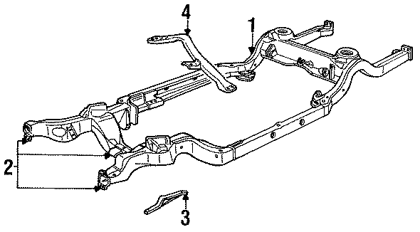

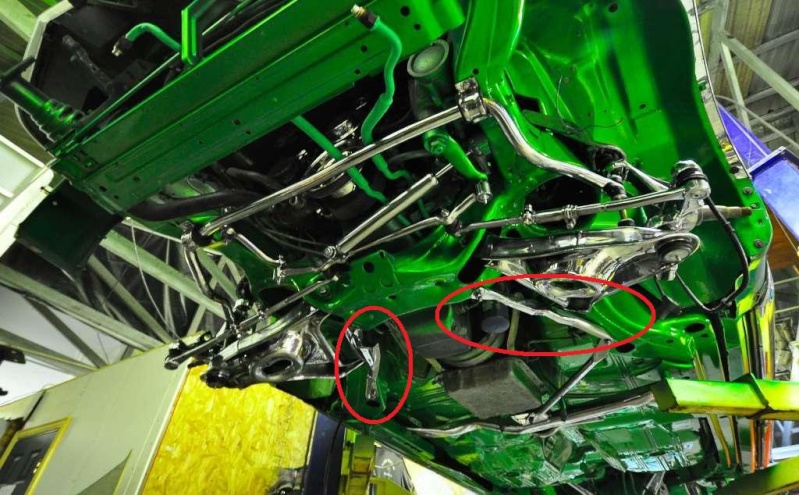

    Now the later design ties everything together, it has three bolting locations versus the original two bolt locations. again sorry for the pics, its the best i could find:

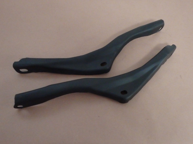

    They are discontinued from GM but their part numbers are 14008434 for the right side and 14008433 for the left side, and heres a close up of what they look like:

    Now for those of you with long tube (full length) headers. You wont be able to put the driver side brace on, unless you have custom made headers, your standard headers for our cars wont allow it, however the passenger side fits. I had taken mine off (the original designed ones) when i had the dual exhaust done, and i was at the junkyard today, and i grabbed a set from a 92 caprice, i thought why not. Its a cheap simple small upgrade. You may not feel any difference in the way it drives, but psychologically you will lol.

    That's pretty cool. Something to think about there. Even shorty headers won't clear? I noticed my passenger side brace was unbolted on one side. This is typical when someone changes a starter and is too lazy to bolt it back.lol
    That one picture has to be a lowrider with all that chrome and paint. All that work and it has a dirty oil pan and transmission pan.lol

    sorry, should have clarified that, long tube headers. Im sure mid length and shorties would clear it. Oh its def a low rider! lol, i believe its a 93 caddy fleetwood
