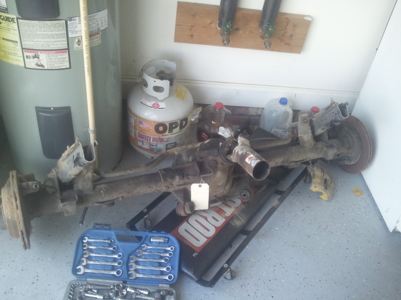

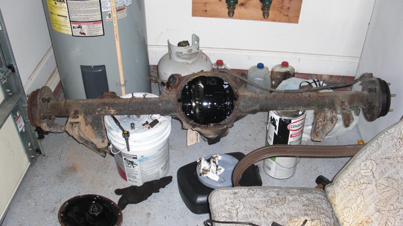

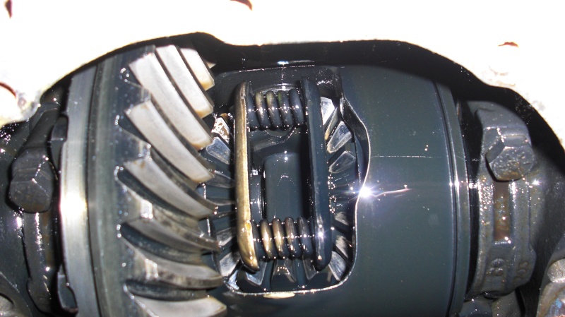

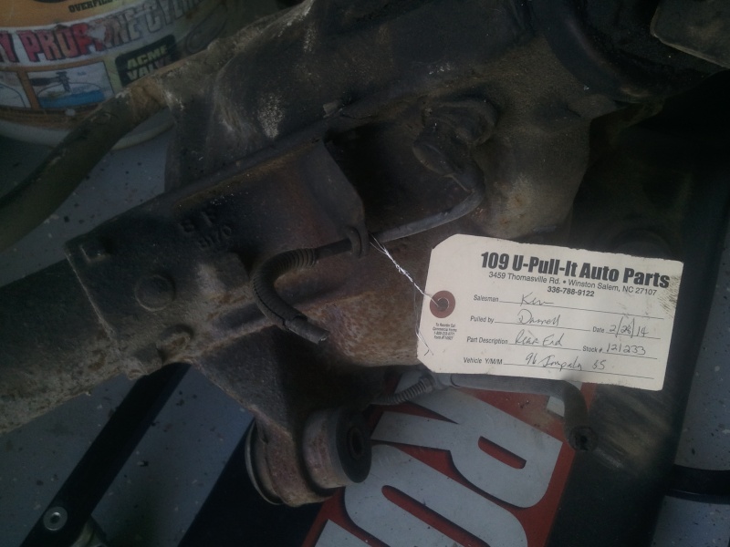

    After months of searching for a 94-96 rear end with disc brakes from either a 9c1 or impala ss, i found one an hour and a half away from me, so i jumped on the highway and bought that sucker. For 300 bucks it was mine. It came from a 96 impala ss, mileage is unknown which is why i got a deal on it from the junkyard. They originally wanted 550 for it. I will have to do an overhaul on everything, rotors, calipers, hoses, etc. But im going to por 15 it, drain and refill with fresh oil, and new cover. It doesnt seem like the posi works from the simple spin the wheel test, its acting like an open diff, with one wheel spinning the opposite way. I do believe it is an auburn cone type posi, which means its not rebuildable. The thing was covered in mud and rust, looks like it has sat for a few years. I didnt get to see the donor car, i wish i could have. But ill get that 9c1 control arm kit for like 45 bucks since they cut the control arms! But they gave me a sway bar so i have two of them now, not sure if i should keep it or scrap it, obviously i dont need two. It will be a few months before install, ill have to get a new master cylinder with a 1 1/4" bore to upgrade the 1 1/8" bore mine currently has and also a proportioning valve for the rear discs, and have the drive shaft shortened. Also since im not changing wheels right away ill have to use an adapter for my bolt pattern, its going to be some work, but ill keep yall updated. And as always heres some pics.
    GM 8.5 10 bolt swap from a 96 impala ss 2014-012
    GM 8.5 10 bolt swap from a 96 impala ss 2014-013
    GM 8.5 10 bolt swap from a 96 impala ss 2014-014
    GM 8.5 10 bolt swap from a 96 impala ss 2014-015
    GM 8.5 10 bolt swap from a 96 impala ss Cimg6911
    GM 8.5 10 bolt swap from a 96 impala ss Cimg6912
    GM 8.5 10 bolt swap from a 96 impala ss Cimg6913
    GM 8.5 10 bolt swap from a 96 impala ss Cimg6914
    somehow a plastic bag got twisted in with the yoke, so ill have to replace the pinion shaft seal, which is a no biggie
