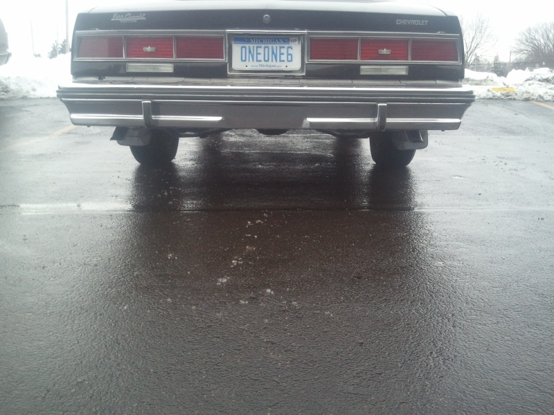

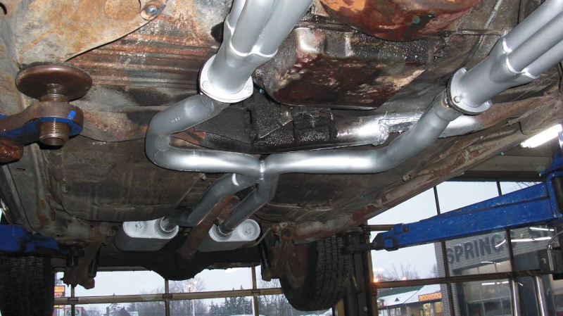

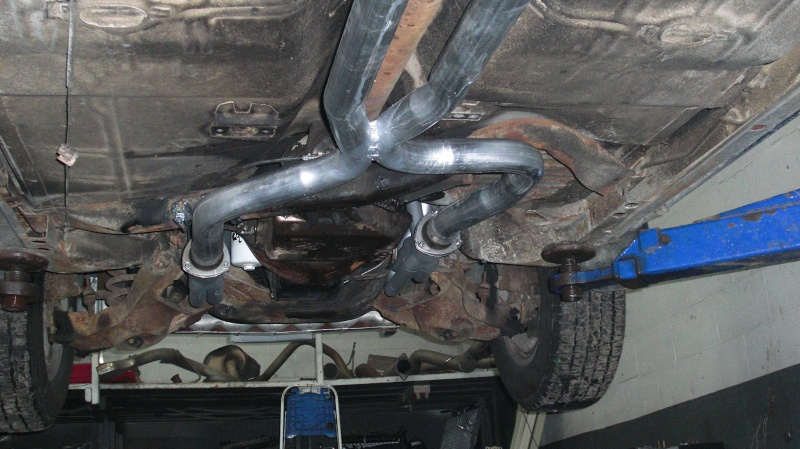

    So I got headers and dual exhaust installed this passed weekend, and has completely changed the sound of the car, but for the good! It sounds so much more aggressive than the stock exhaust. Had to notch the crossmember, but it was totally worth it. I used Flowtech 11100FLT headers, had them sand blasted, then painted with Eastwoods Internal Exhaust Coating, both inside and outside of the headers. There were no fitment problems on the drivers side, but the passenger side was a little harder to install. As it is now, the passenger side header hits the starter block which connects it to the motor, it i want to change the starter, the header would have to be removed, or at least loosened (hopefully the starter dont go out any time soon, fingers crossed!) There was also this metal tube that encases the starter wires from the heat, that had to be moved, that part caused alot of problems because we couldnt see it during the install and couldnt figure what the header was hitting, and wouldnt go into place, so we bent some of the tubes because they were hitting the frame, but after we moved that tube for the starter wires, it was all good, and ended up not even needing to have bent the tubes in the first place. Its ran using 2 1/2 piping, siamesed in the middle, and some offbrand flowmaster original super 40 series mufflers. Sounds good with the stock GM Goodwrench 350 crate motor.

    On the crossmember notch did u weld new metal in there??...
    I was thinking of getting a flex coupler and shove it between the crossmember and floor plan ..lol
    Will that work too or will it cause too much restriction..
    Thanks8)
    Chevy Caprice Dual Exhaust Empty Re: Chevy Caprice Dual Exhaust
    Post  GM B-Body Forum Wed Jul 03, 2013 11:11 pm
    Thanks man, my step dad did this, he had a huge piece of steel, I think it was half inch thick that he welded in there, completely retarded thick, but its solid and aint moving! Im not sure if id trust a flex coupler in something like that, i would definitely weld in a piece of steel or fab a new crossmember for that.

    ohhh ok i get what you mean now, i still wouldnt do it, it would be to close to the floor pan and im sure it will burn all the undercoating off, and the carpet inside might get really hot too. There is actually another option, you can heat the crossmember to the point where you can bend it, i asked my step dad to do it, and he said its possible but it be alot of work. And there are only two AN lines i have, thats from the fuel pump to the regulator and then to the carb. I said screw it after that, those things are too hard, i just installed braided sleeving on the radiator hoses, and other random hose lines, this is the website i bought it from http://www.cabletiesandmore.com/american/catalog/expandable-sleeving-c-69_70.php

    Expect to pay a pretty penny at a local shop! For the most part you wont have to modify the crossmember like i did, you can have the pipe run right under it if you use headers, but youll see the pip hanging down. Yeah I didnt have the greatest luck with the car the first year haha, when the original motor blew, i got a replacement motor at my local junkyard, a week after i got my car back that motor also spun a rod bearing, so i had just wasted a 1,000 bucks on that and i was stranded again, so at that point, i let the car sit for 4 months and saved up for a new gm crate motor, and it was the best decision i have made, this was over a year and a half ago. 4 new tires, 1 new motor, brakes, exhaust, radiator, carburetor, and many other parts later, we're still running strong!! I would like to drop in a 700 hp 434 sbc, with a th400, maybe a 9inch rear or gm 12 bolt. Id like to do a full body off frame restore at some point. Some wide tires all the way around, disc brakes all the way around, poly bushings, tubular control arms, lower the car an inch or so overall, and just spend ridiculous amounts of money on it haha. I didnt help my dad with the exhaust, all i did was put the headers on and he did the rest, but ofcourse i watched the whole time. Since he works at a shop, he was able to use the pipe bender, welder, etc, I just paid for the parts, the tubing, mufflers, and clamps. This is definitely something you really cant do at home, if you do take your car, take the pics of my car with you and show them, if they dont already know how to do it. I guarantee you they will charge you $500+ not including parts, you might get out under $1,000, best of luck to you bro! ask any questions!
